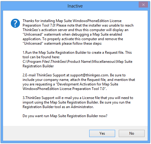

Map Suite Windows Phone Edition can also be installed even when an Internet connection is not available, although additional steps are required. Initially, installation is similar to the online installation process described above. The exception is that, at the end of the installation, the following dialog box will appear:
The dialog box provides two options.
  • If you answer Yes, you will be presented with the Map Suite Registration Builder, with which you can register your copy of Map Suite manually.
  • If you answer No, Map Suite will be installed without registration information and will operate in evaluation mode. This means you will see an “Unlicensed” watermark on your maps.
Click “Yes” to register manually and the Map Suite Registration Builder will display, as shown:
Click the “Generate Request File” button, which will create a special file with a .request extension. You will then need to send that file by email to support@thinkgeo.com with a short description about your installation – for example, your name, company (if applicable), email address, etc. ThinkGeo's support staff will process your request, typically within one business day, and send you back a new file with a .license extension.
