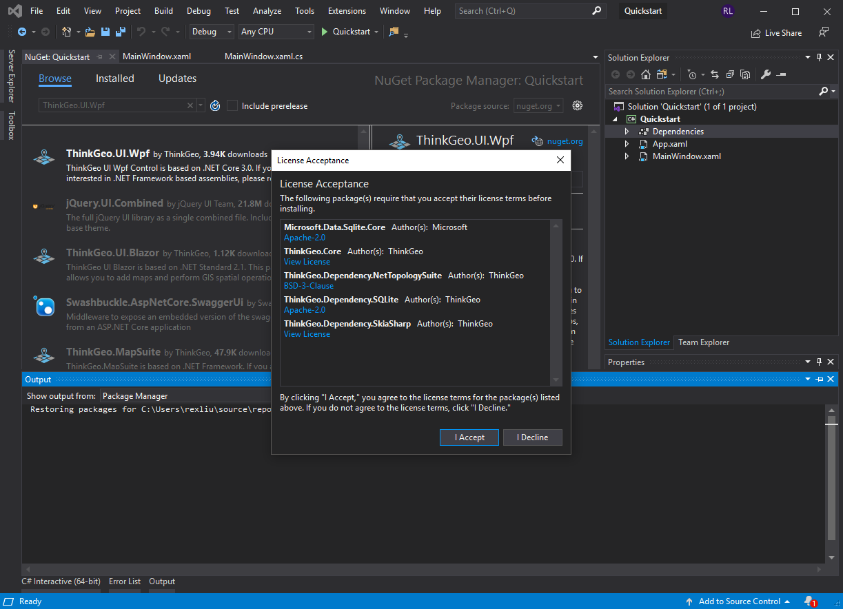

The project Quickstart sample is created in a new solution called Quickstart. The wizard creates a single WPF Application. Next we need to install ThinkGeo.UI.Wpf from the Nuget package server (see Figure 2-5).
Figure 2. Refer to Manage NuGet Packages.
Figure 3. Refer to ThinkGeo.UI.Wpf.
Now the package is installing into the project.
The “NetTopologySuite” is the third part assembly, so the license acceptance is required. You can click “I Accept” to agree the license.(See Figure 4)
Figure 4. NuGet installation success.

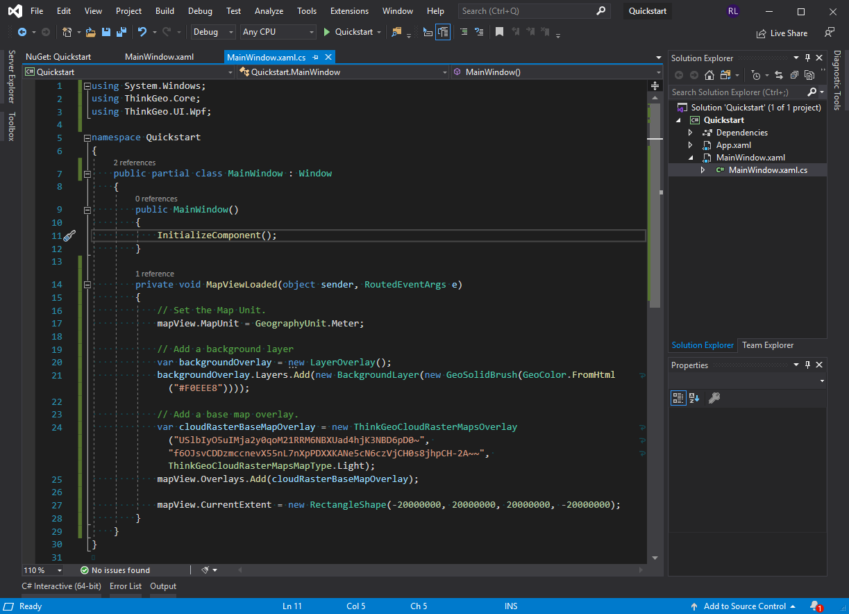

Our next step is to define and add our base map overlay. All of the following code can be placed in the ​MapViewLoaded​ event of the form. Here is the code to use for our example(see Figure 7).
using System.Windows;
using ThinkGeo.Core;
using ThinkGeo.UI.Wpf;
namespace Quickstart
    public partial class MainWindow : Window
        public MainWindow()
            InitializeComponent();
        private void MapViewLoaded(object sender, RoutedEventArgs e)
            // Set the Map Unit.
            mapView.MapUnit = GeographyUnit.Meter;
            // Add a background layer
            var backgroundOverlay = new LayerOverlay();
            backgroundOverlay.Layers.Add(new BackgroundLayer(new GeoSolidBrush(GeoColor.FromHtml("#F0EEE8"))));
            // Add a base map overlay.
            var cloudRasterBaseMapOverlay = new ThinkGeoCloudRasterMapsOverlay("USlbIyO5uIMja2y0qoM21RRM6NBXUad4hjK3NBD6pD0~", "f6OJsvCDDzmccnevX55nL7nXpPDXXKANe5cN6czVjCH0s8jhpCH-2A~~", ThinkGeoCloudRasterMapsMapType.Light);
            mapView.Overlays.Add(cloudRasterBaseMapOverlay);
            mapView.CurrentExtent = new RectangleShape(-20000000, 20000000, 20000000, -20000000);
Figure 7. Add base map overlay to map view.

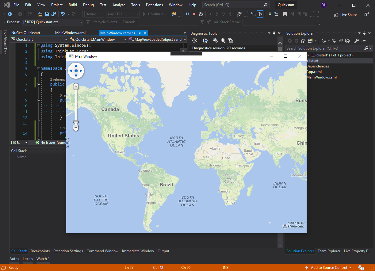

You can get a normal map render (See Figure 8)
Figure 8 Quickstart Run Result.
NOTE: It is important that the “MapUnit” property of a Map object be set using the “GeographyUnit” enumeration, which can be in DecimalDegree, feet, meters, etc., and our map has no idea about what the unit of measurement is until we set it. This information is normally found somewhere in the documentation or within the supplemental data file as discussed in the section on ShapeFiles.

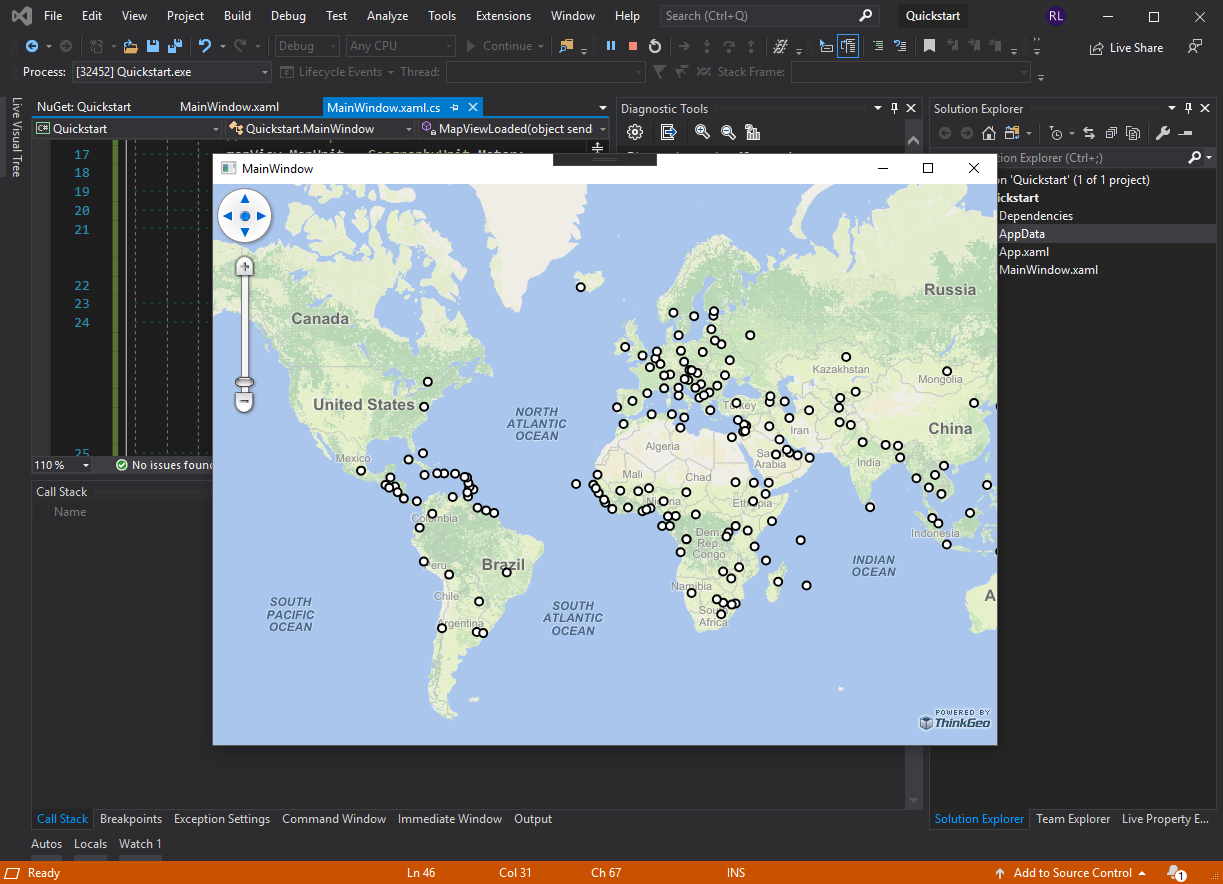

And the result is as follows (Figure 10):
Figure 10. Shapefile layer rendering result.
So what has occurred here? We have created a layer and added it to the Map and the Map has rendered according to its default style parameters. Also, we have used ZoomLevel to display the map the way that we want.
