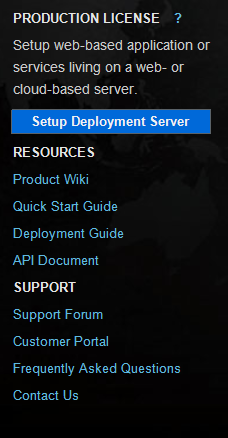

Please follow the below steps to setup the deployment license.
