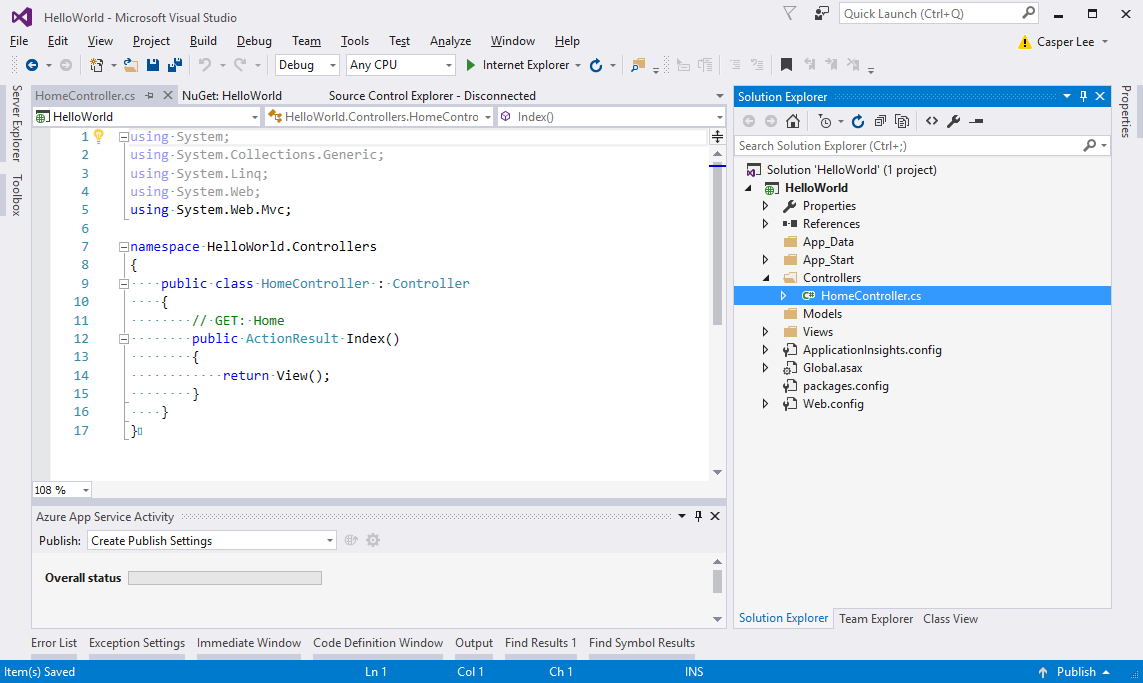

In Solution Explorer, right-click on the “Controller” folder, then navigate to “Add” and select “Controller…” to add a new controller page named “HomeController”. It should look like the screenshot below:
Now move your mouse pointer over the code “return View()” and right-click to add the responding view page. Keep all of the default settings as shown below:
