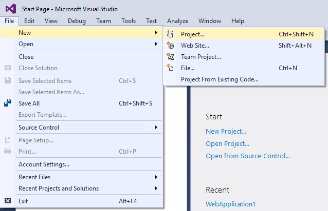

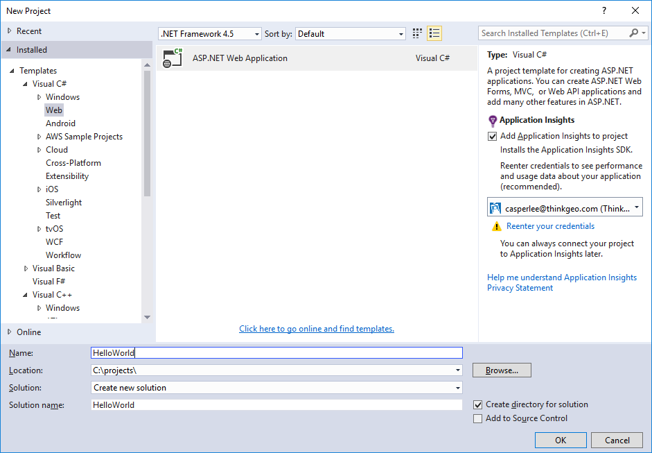

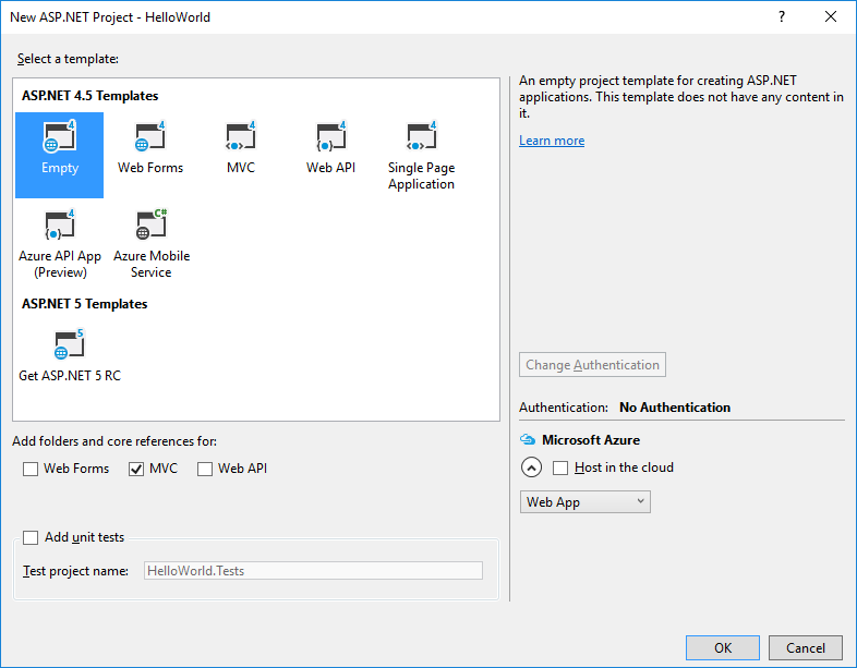

Let's start with a new ASP.NET MVC 4 web application in Visual Studio.NET 2015 IDE and call it “HelloWorld” (see Figure 1). (NOTE: Map Suite MVC Edition supports both the Razor and ASPX view engines. In this guide we are just using Razor as an example.)
In this sample, we are going to implement following six items:
This Quick Start Guide uses an ASP.NET MVC 4 web application as an example, so you will need to have the ASP.NET MVC framework installed in order to follow along. The MVC 4 framework can be downloaded from ASP.NET MVC 4 Tools Update.
Figure 1. Creating a new project in Visual Studio.NET 2015 IDE.

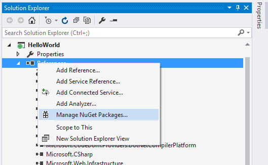

Right-click on “References” in Solution Explorer and select “Manage NuGet Packages…”
Search the packages list above and install them. (See Figure 2).

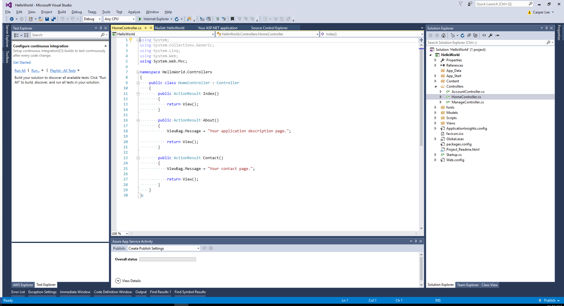

In Solution Explorer, open “HomeControler.cs” file on the “Controllers” folder, it contains three actions when it is created, it looks like the screenshot below:

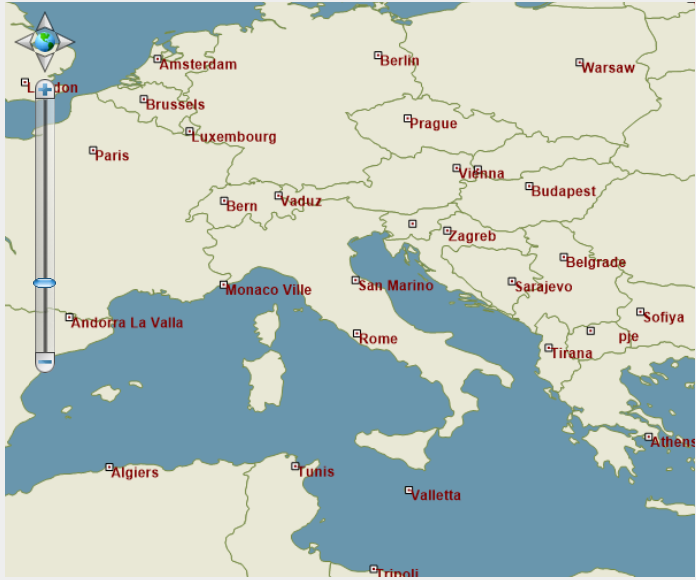

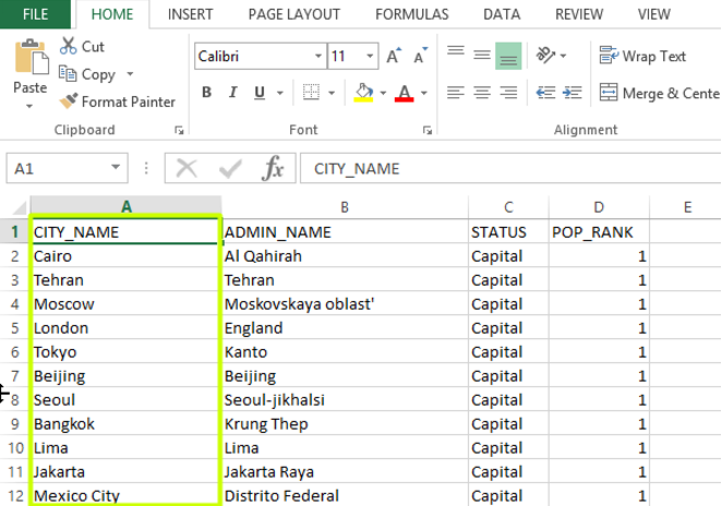

A TextStyle is used to label items on map. As every ShapeFile has a related .dbf file that includes descriptions for each record, the most common way to use the TextStyle is for labeling features. For example, the ShapeFile containing capitals of the world has a corresponding .dbf file contains the field “CITY_NAME”. We can use this field to label the cities on our map.
Map Suite has many TextStyles built in to help us quickly design attractive labels for the cities on our map. We can just pick the TextStyle we like and use it.
@{Html.ThinkGeo().Map("Map1", 600, 500) .MapBackground(new GeoSolidBrush(GeoColor.FromHtml("#E5E3DF"))) .CurrentExtent(5, 78, 30, 26) .MapUnit(GeographyUnit.DecimalDegree) .StaticOverlay(overlay => { // World layer ShapeFileFeatureLayer worldLayer = new ShapeFileFeatureLayer(Server.MapPath("~/App_Data/Countries02.shp")); AreaStyle areaStyle = new AreaStyle(); areaStyle.FillSolidBrush = new GeoSolidBrush(GeoColor.FromArgb(255, 233, 232, 214)); areaStyle.OutlinePen = new GeoPen(GeoColor.FromArgb(255, 118, 138, 69), 1); areaStyle.OutlinePen.DashStyle = LineDashStyle.Solid; worldLayer.ZoomLevelSet.ZoomLevel01.DefaultAreaStyle = areaStyle; worldLayer.ZoomLevelSet.ZoomLevel01.ApplyUntilZoomLevel = ApplyUntilZoomLevel.Level20; overlay.Layer(worldLayer); // Capital layer ShapeFileFeatureLayer capitalLayer = new ShapeFileFeatureLayer(Server.MapPath("~/App_Data/WorldCapitals.shp")); PointStyle pointStyle = new PointStyle(); pointStyle.SymbolType = PointSymbolType.Square; pointStyle.SymbolSolidBrush = new GeoSolidBrush(GeoColor.StandardColors.White); pointStyle.SymbolPen = new GeoPen(GeoColor.StandardColors.Black, 1); pointStyle.SymbolSize = 6; PointStyle stackStyle = new PointStyle(); stackStyle.SymbolType = PointSymbolType.Square; stackStyle.SymbolSolidBrush = new GeoSolidBrush(GeoColor.StandardColors.Maroon); stackStyle.SymbolPen = new GeoPen(GeoColor.StandardColors.Transparent, 0); stackStyle.SymbolSize = 2; pointStyle.CustomPointStyles.Add(stackStyle); capitalLayer.ZoomLevelSet.ZoomLevel01.DefaultPointStyle = pointStyle; GeoFont font = new GeoFont("Arial", 9, DrawingFontStyles.Bold); GeoSolidBrush txtBrush = new GeoSolidBrush(GeoColor.StandardColors.Maroon); TextStyle textStyle = new TextStyle("CITY_NAME", font, txtBrush); textStyle.XOffsetInPixel = 0; textStyle.YOffsetInPixel = -6; capitalLayer.ZoomLevelSet.ZoomLevel01.DefaultTextStyle = textStyle; capitalLayer.ZoomLevelSet.ZoomLevel01.ApplyUntilZoomLevel = ApplyUntilZoomLevel.Level20; overlay.Layer(capitalLayer); }) .Render(); }
The result is as follows (Figure 5):

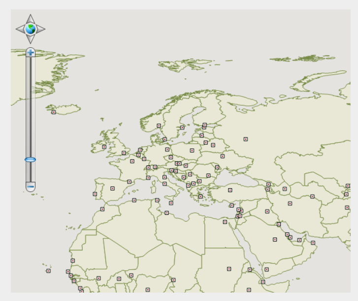

Now that we know how to render text and render symbols, let's define two different ZoomLevels in one single layer and create our own custom Style and TextStyle.
@{Html.ThinkGeo().Map("Map1", 600, 500) .MapBackground(new GeoSolidBrush(GeoColor.GeographicColors.ShallowOcean)) .CurrentExtent(5, 78, 30, 26) .MapUnit(GeographyUnit.DecimalDegree) .StaticOverlay(overlay => { // All of this code can alternatively be placed in the controller. // Please reference the sample applications that came with your copy of Map Suite MVC Edition for detail. // World layer ShapeFileFeatureLayer worldLayer = new ShapeFileFeatureLayer(Server.MapPath("~/App_Data/Countries02.shp")); AreaStyle areaStyle = new AreaStyle(); areaStyle.FillSolidBrush = new GeoSolidBrush(GeoColor.FromArgb(255, 233, 232, 214)); areaStyle.OutlinePen = new GeoPen(GeoColor.FromArgb(255, 118, 138, 69), 1); areaStyle.OutlinePen.DashStyle = LineDashStyle.Solid; worldLayer.ZoomLevelSet.ZoomLevel01.DefaultAreaStyle = areaStyle; worldLayer.ZoomLevelSet.ZoomLevel01.ApplyUntilZoomLevel = ApplyUntilZoomLevel.Level20; overlay.Layer(worldLayer); // Capital layer ShapeFileFeatureLayer capitalLayer = new ShapeFileFeatureLayer(Server.MapPath("~/App_Data/WorldCapitals.shp")); // We can customize our own Style. Here we pass in a color and a size. PointStyle pointStyle = new PointStyle(); pointStyle.SymbolType = PointSymbolType.Square; pointStyle.SymbolSolidBrush = new GeoSolidBrush(GeoColor.StandardColors.White); pointStyle.SymbolPen = new GeoPen(GeoColor.StandardColors.Black, 1); pointStyle.SymbolSize = 6; PointStyle stackStyle = new PointStyle(); stackStyle.SymbolType = PointSymbolType.Square; stackStyle.SymbolSolidBrush = new GeoSolidBrush(GeoColor.StandardColors.Maroon); stackStyle.SymbolPen = new GeoPen(GeoColor.StandardColors.Transparent, 0); stackStyle.SymbolSize = 2; pointStyle.CustomPointStyles.Add(stackStyle); capitalLayer.ZoomLevelSet.ZoomLevel01.DefaultPointStyle = PointStyles.CreateSimpleCircleStyle(GeoColor.StandardColors.White, 7, GeoColor.StandardColors.Brown); // The Style we set here is applied from ZoomLevel01 to ZoomLevel05. That means if we zoom in a bit more, this particular style will not be visible anymore. capitalLayer.ZoomLevelSet.ZoomLevel01.ApplyUntilZoomLevel = ApplyUntilZoomLevel.Level05; capitalLayer.ZoomLevelSet.ZoomLevel06.DefaultPointStyle = pointStyle; // The Style we set here is applied from ZoomLevel06 to ZoomLevel20. That means if we zoom out a bit more, this particular style will not be visible anymore. capitalLayer.ZoomLevelSet.ZoomLevel06.ApplyUntilZoomLevel = ApplyUntilZoomLevel.Level20; overlay.Layer(capitalLayer); // Label layer ShapeFileFeatureLayer capitalLabelLayer = new ShapeFileFeatureLayer(Server.MapPath("~/App_Data/WorldCapitals.shp")); // We can customize our own TextStyle. Here we pass in the font, the size, the style and the color. capitalLabelLayer.ZoomLevelSet.ZoomLevel01.DefaultTextStyle = TextStyles.CreateSimpleTextStyle("CITY_NAME", "Arial", 8, DrawingFontStyles.Italic, GeoColor.StandardColors.Black, 3, 3); // The TextStyle we set here is applied from ZoomLevel01 to ZoomLevel05. capitalLabelLayer.ZoomLevelSet.ZoomLevel01.ApplyUntilZoomLevel = ApplyUntilZoomLevel.Level05; GeoFont font = new GeoFont("Arial", 9, DrawingFontStyles.Bold); GeoSolidBrush txtBrush = new GeoSolidBrush(GeoColor.StandardColors.Maroon); TextStyle textStyle = new TextStyle("CITY_NAME", font, txtBrush); textStyle.XOffsetInPixel = 0; textStyle.YOffsetInPixel = -6; capitalLabelLayer.ZoomLevelSet.ZoomLevel06.DefaultTextStyle = textStyle; // The TextStyle we set here is applied from ZoomLevel06 to ZoomLevel20. capitalLabelLayer.ZoomLevelSet.ZoomLevel06.ApplyUntilZoomLevel = ApplyUntilZoomLevel.Level20; overlay.Layer(capitalLabelLayer); }) .Render(); }
Can you imagine what the map will look like now? Figure 7 below is the result. At first it looks the same as it did in Figure 6. Now zoom in, and watch the map change to resemble Figure 7 as you do.
Figure 6. A map of European cities with two ZoomLevels, before zooming in.
Figure 7. The same map with two ZoomLevels, after zooming in.

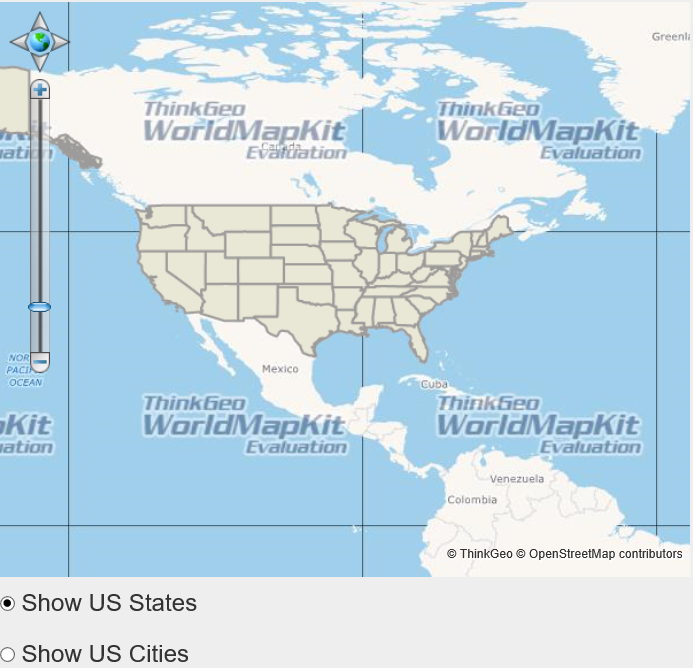

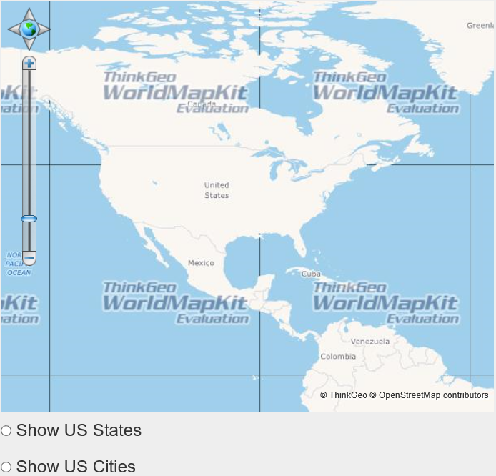

If we compile and run the application now, it should look like the screenshot below:
You can click the checkboxes for “Show US States” or “Show US Cities” to load different layers to the map. For example, if you check the “Show US States” box, the map should look like this:
