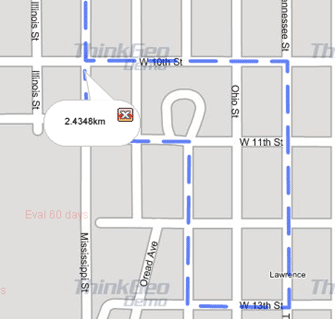

(5) Measure Tool
Click this button to activate the measurement function on the map. When this function is activated, you can click on the map to begin drawing a polyline (a line with one or more segments). Each additional click will begin drawing a new segment of the same line. You can double-click to finish drawing the polyline. When you do, a bubble displaying the total length of the line will appear on the map.
