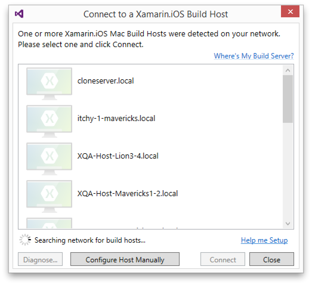

You can change the Mac Build Host by clicking the Find Mac Build Host button. The following screen is displayed to update the Mac Build Host:
Figure 4. Updating the Mac Build Host.
Note: The version of Xamarin.iOS being used with VisualStudio must be the same as on the Mac. The simplest method to keep them in sync is to have both machines running on the same branch (e.g. both on the Stable release branch).
Enter the PIN number generated from Mac Xamarin.iOS
