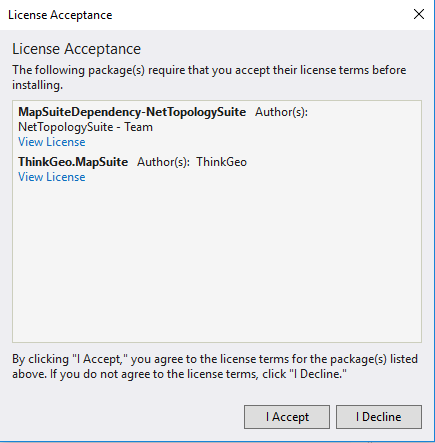

The “NetTopologySuite” is the third part assembly, so the license acceptance is required. You can click “I Accept” to agree the license.
