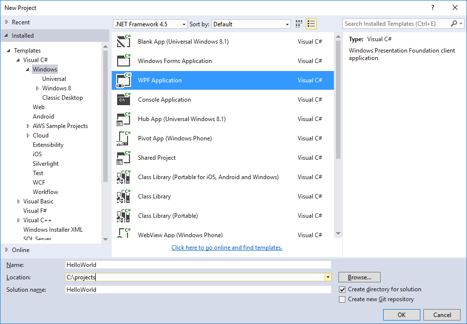

Please following our Map Suite Desktop guide for winforms development environment. Let's start with a new WPF project in Microsoft Visual Studio (2015 or newer) and call it HelloWorld (see Figure 1). We can create the project with .NET Framework 4.0 or 4.5.
The project HelloWorld is created in a new solution called HelloWorld. The wizard creates a single WPF Application. Next we need to install MapSuiteDesktopForWpf-BareBone, ThinkGeo.MapSuite.Layers.Background and ThinkGeo.MapSuite.Layers.ShapeFile from nugget package server (see Figure 2-5).

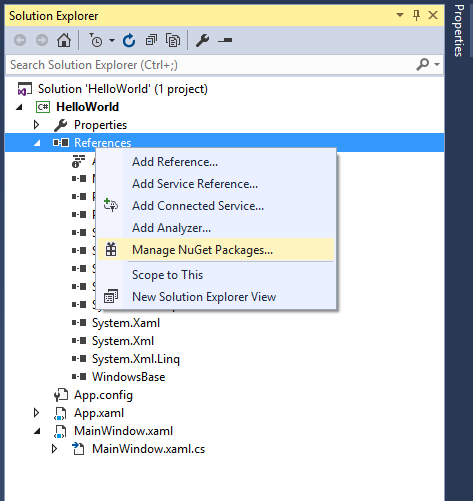

Figure 2. Refer to Manage NuGet Packages.

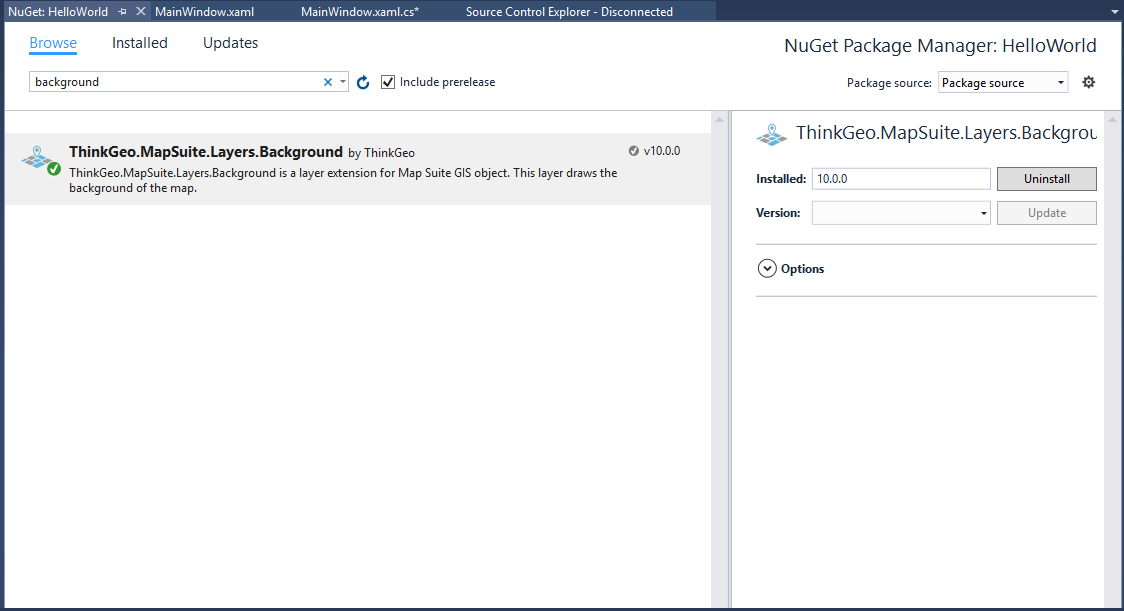

Figure 4. Refer to ThinkGeo.MapSuite.Layers.ShapeFile.
Figure 5. Refer to ThinkGeo.MapSuite.Layers.Background.

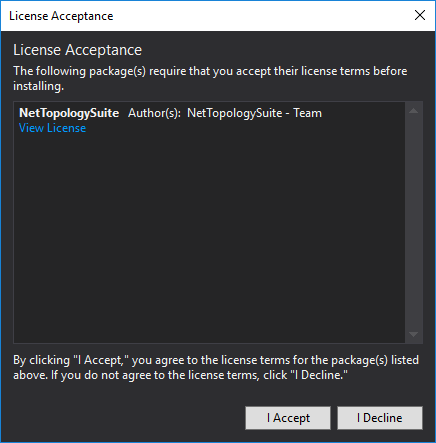

Now the package is installing into the project.
The “NetTopologySuite” is the third part assembly, so the license acceptance is required. You can click “I Accept” to agree the license.

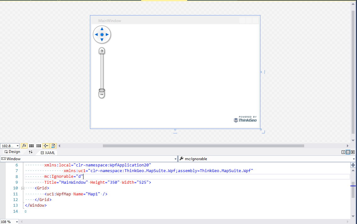

You can open your .xaml file and add reference code to refer Wpf map to your application (See Figure 6)
<Window x:Class="HelloWorld.MainWindow"
        xmlns="http://schemas.microsoft.com/winfx/2006/xaml/presentation"
        xmlns:x="http://schemas.microsoft.com/winfx/2006/xaml"
        xmlns:d="http://schemas.microsoft.com/expression/blend/2008"
        xmlns:mc="http://schemas.openxmlformats.org/markup-compatibility/2006"
        xmlns:local="clr-namespace:HelloWorld"
        mc:Ignorable="d"
        xmlns:uc1="clr-namespace:ThinkGeo.MapSuite.Wpf;assembly=ThinkGeo.MapSuite.Wpf"
        Title="MainWindow" Height="600" Width="800">
    <Grid>
        <uc1:WpfMap Name="Map1" Loaded="Map1_Loaded"/>
    </Grid>
</Window>
Figure 6. Add Map Control to your application.

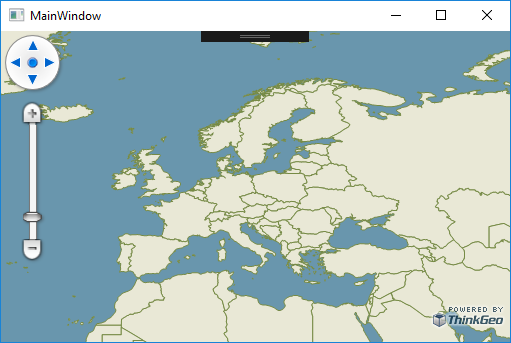

Now it is time to press F5 to start the application. If you have not set up a developer license, ​the Map Suite Product Center will pop up. You need to generate your developer license. For more details, please refer to http://wiki.thinkgeo.com/wiki/map_suite_developer_license_guide.
Once the developer license is ready, run the application. Your map should look like the one below: (see Figure 7).
Figure 7. The normal map is rendered after the developer license file has been got.

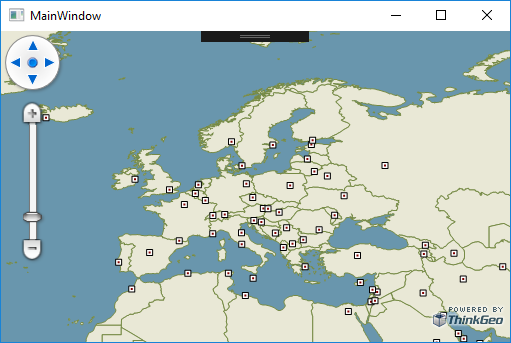

And the result is as follows (Figure 9):
Figure 9. Map of Europe with 2 layers.

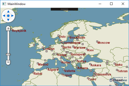

The result is as follows (Figure 10):
Figure 10. Map of Europe with a TextStyle.

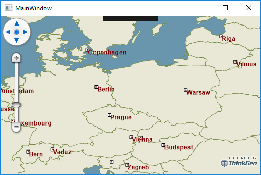

Now that we know how to render text and render symbols, let's define two different ZoomLevels in one single layer, and create our own custom Style and TextStyle.

Can you imagine what the map will look like now? Below is the result. At first it appears like figure 11, and the map changes to figure 12 as you zoom in.
Figure 11. Europe Map with two ZoomLevels, before Zoom In.
Figure 12. Europe Map with two ZoomLevels, after Zoom In.
