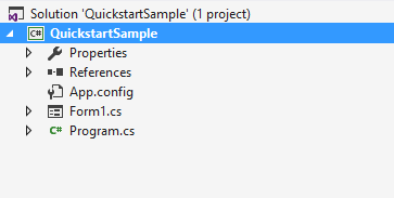

After you created a QuickstartSample project, we will see a project in the solution, please see Figure 2.
Figure 2. Create WinForms Project.

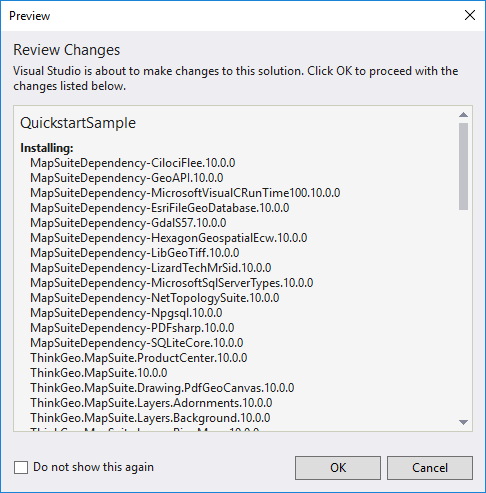

Click “OK” if the message box like Figure 5 pops up.
Figure 5. Review package references.
The “NetTopologySuite” is the third part assembly, so the license acceptance is required. You can click “I Accept” to agree the license.(See Figure 6)
Figure 6. NuGet installation success.
Once the package is installed, you can see the message “Successfully installed 'MapSuiteDesktopForWinForms-Standard' to QuickstartSample” in your Microsoft Visual Studio Output box. Some Desktop assemblies have been added into the project references. (See Figure 7).
Figure 7. NuGet installation result.

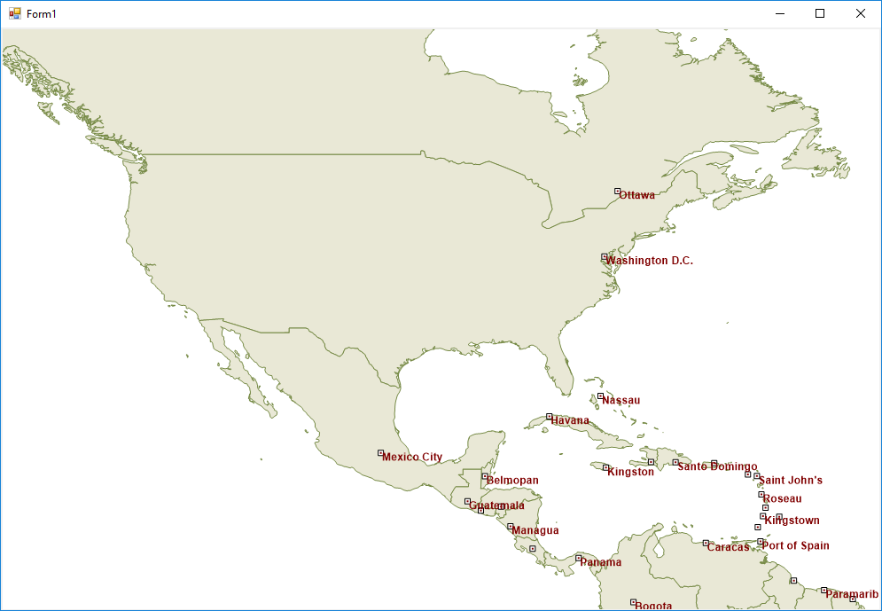

The result is as follows (Figure 14):
Figure 14. Map of Europe with a TextStyle.

Can you imagine what the map will look like now? Below is the result. At first it appears like figure 15, and the map changes to figure 8 as you zoom in.
Figure 15. A map of Europe with two ZoomLevels, before zooming in.
Figure 16. The same map with two ZoomLevels, after zooming in.
