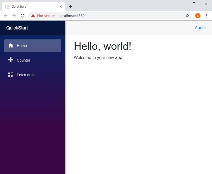

  6. Press F5 to run the app, you can see the browser is launched as following:
Now, you successfully created a native blazor serverside sample. See Get started with ASP.NET Core Blazor, If there are any issue during running this sample.

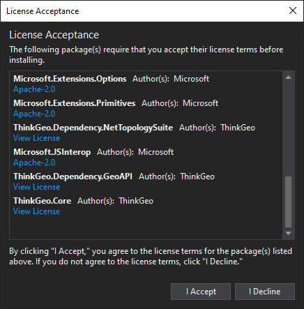

  3. Now the package is installing into the project. Click “OK” if the message box like the following pops up.

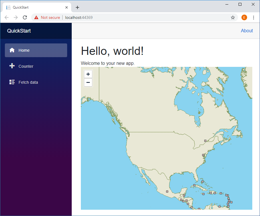

Run the app by pressing F5. If you have not set up a developer license, the Map Suite Product Center will pop up. You will need to activate your developer license, either by starting a free evaluation of ThinkGeo UI Web for Blazor, or by purchasing the full edition of the product. For more details, please refer to our developer license guide.
Once your developer license is ready, run the application. Your map should look like the one below:

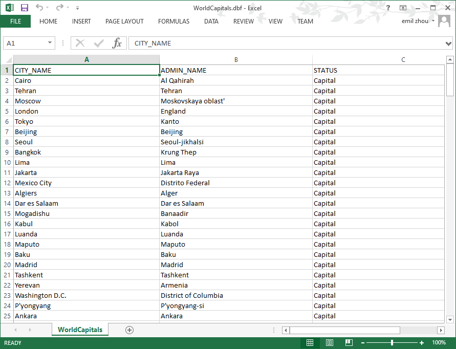

TextStyles are used to label items on the map. Because every ShapeFile has a companion .dbf file that includes descriptions for each record, the most common way to use TextStyles is for labeling features with these descriptive values. For example, the WorldCapitals Shapefile's corresponding .dbf file contains the field “CITY_NAME”. We can use this field to label the cities on our map.
ThinkGeo.Core has many TextStyles built in to help us quickly design attractive labels for the cities on our map. We can just pick the TextStyle we like and use it.

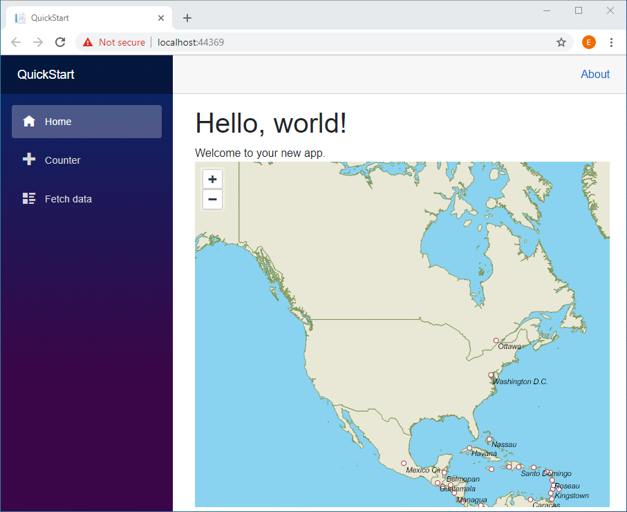

        // We create a new Layer for labeling the capitals.
        ShapeFileFeatureLayer capitalLabelLayer = new ShapeFileFeatureLayer("./Data/capitals/WorldCapitals.shp");
        capitalLabelLayer.FeatureSource.ProjectionConverter = new ProjectionConverter(4326, 3857);
        GeoFont font = new GeoFont("Arial", 9, DrawingFontStyles.Bold);
        GeoSolidBrush txtBrush = new GeoSolidBrush(GeoColors.Maroon);
        TextStyle textStyle = new TextStyle("CITY_NAME", font, txtBrush);
        textStyle.XOffsetInPixel = 0;
        textStyle.YOffsetInPixel = -6;
        // We use the preset TextStyle. Here we passed in the “CITY_NAME”,
        // which is the name of the field we want to show on the map.
        capitalLabelLayer.ZoomLevelSet.ZoomLevel01.DefaultTextStyle = textStyle;
        capitalLabelLayer.ZoomLevelSet.ZoomLevel01.ApplyUntilZoomLevel = ApplyUntilZoomLevel.Level20;
        layers.Add(capitalLabelLayer);
Now that we know how to render text and render symbols, let's define two different ZoomLevel ranges in one single layer, and create our own custom Style and TextStyle.
        capitalLabelLayer.ZoomLevelSet.ZoomLevel01.DefaultTextStyle = TextStyle.CreateSimpleTextStyle("CITY_NAME", "Arial", 8, DrawingFontStyles.Italic, GeoColors.Black, 3, 3);
        // The TextStyle we set here is available from ZoomLevel01 to ZoomLevel05.
        capitalLabelLayer.ZoomLevelSet.ZoomLevel01.ApplyUntilZoomLevel = ApplyUntilZoomLevel.Level05;
        capitalLabelLayer.ZoomLevelSet.ZoomLevel06.DefaultTextStyle = textStyle;
        // The TextStyle we set here is available from ZoomLevel06 to ZoomLevel20.
        capitalLabelLayer.ZoomLevelSet.ZoomLevel06.ApplyUntilZoomLevel = ApplyUntilZoomLevel.Level20;
        // We need to add the capitalLayer to the LayerOverlay in the map.
Below is the result.
The PointStyle will change as you zoom in.
