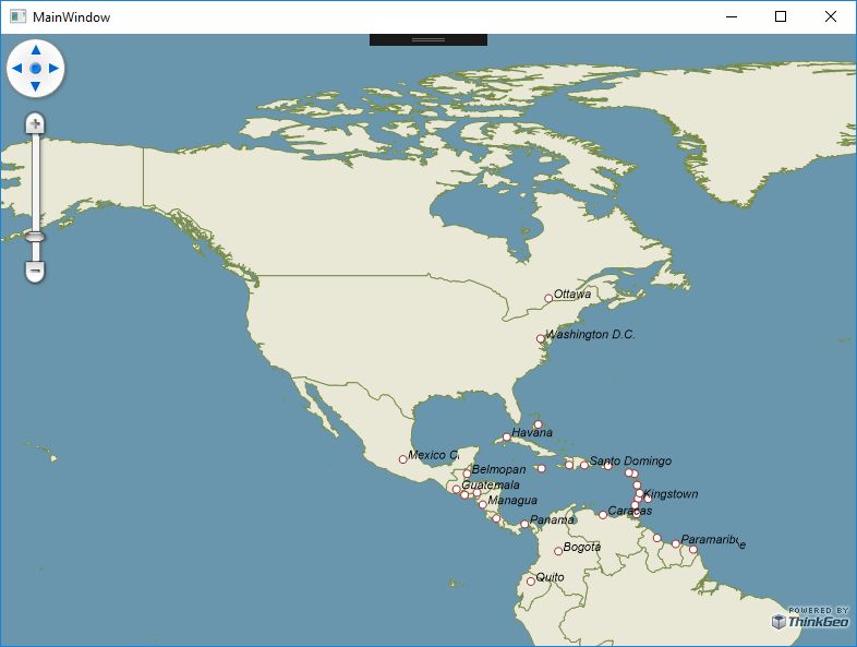

How to Use GeoTextStyle
TextStyle
TextStyles are used to label items on the map. As every ShapeFile has a relative .dbf file that includes descriptions for every record, the most common way to use TextStyles is for labeling. For example, the WorldCapitals Shapefile's corresponding .dbf file contains the field “CITY_NAME”. We can use this field to label the cities on our map.
Map Suite has many TextStyles built in to help us quickly design attractive labels for the cities on our map. We can just pick the TextStyle we like and use it.
private void Map1_Loaded(object sender, RoutedEventArgs e)
    Map1.MapUnit = GeographyUnit.DecimalDegree;
    ShapeFileFeatureLayer worldLayer = new ShapeFileFeatureLayer(@"../../Data/Countries02.shp");
    AreaStyle areaStyle = new AreaStyle();
    areaStyle.FillSolidBrush = new GeoSolidBrush(GeoColor.FromArgb(255, 233, 232, 214));
    areaStyle.OutlinePen = new GeoPen(GeoColor.FromArgb(255, 118, 138, 69), 1);
    areaStyle.OutlinePen.DashStyle = LineDashStyle.Solid;
    worldLayer.ZoomLevelSet.ZoomLevel01.DefaultAreaStyle = areaStyle;
    worldLayer.ZoomLevelSet.ZoomLevel01.ApplyUntilZoomLevel = ApplyUntilZoomLevel.Level20;
    ShapeFileFeatureLayer capitalLayer = new ShapeFileFeatureLayer(@"../../Data/WorldCapitals.shp");
    PointStyle pointStyle = new PointStyle();
    pointStyle.SymbolType = PointSymbolType.Square;
    pointStyle.SymbolSolidBrush = new GeoSolidBrush(GeoColor.StandardColors.White);
    pointStyle.SymbolPen = new GeoPen(GeoColor.StandardColors.Black, 1);
    pointStyle.SymbolSize = 6;
    PointStyle stackStyle = new PointStyle();
    stackStyle.SymbolType = PointSymbolType.Square;
    stackStyle.SymbolSolidBrush = new GeoSolidBrush(GeoColor.StandardColors.Maroon);
    stackStyle.SymbolPen = new GeoPen(GeoColor.StandardColors.Transparent, 0);
    stackStyle.SymbolSize = 2;
    pointStyle.CustomPointStyles.Add(stackStyle);
    capitalLayer.ZoomLevelSet.ZoomLevel01.DefaultPointStyle = pointStyle;
    // This setting also applies from ZoonLevel01 to ZoomLevel20, that means we can see city symbols the same style with ZoomLevel01 all the time.
    // We create a new Layer for labeling the capitals.
    ShapeFileFeatureLayer capitalLabelLayer = new ShapeFileFeatureLayer(@"../../Data/WorldCapitals.shp");
    GeoFont font = new GeoFont("Arial", 9, DrawingFontStyles.Bold);
    GeoSolidBrush txtBrush = new GeoSolidBrush(GeoColor.StandardColors.Maroon);
    TextStyle textStyle = new TextStyle("CITY_NAME", font, txtBrush);
    textStyle.XOffsetInPixel = 0;
    textStyle.YOffsetInPixel = -6;
    // We use the preset TextStyle. Here we passed in the “CITY_NAME”, which is the name of the field we want to label on map.
    capitalLabelLayer.ZoomLevelSet.ZoomLevel01.DefaultTextStyle = textStyle;
    capitalLabelLayer.ZoomLevelSet.ZoomLevel01.ApplyUntilZoomLevel = ApplyUntilZoomLevel.Level20;
    // As the map is drawn by tiles, it needs to draw on the margin to make sure the text is complete after we joining the tiles together.
    // Change the number to another one (for example 0) and you can see the difference expecially when panning.
    LayerOverlay layerOverlay = new LayerOverlay();
    layerOverlay.Layers.Add(new BackgroundLayer(new GeoSolidBrush(GeoColor.GeographicColors.ShallowOcean)));
    layerOverlay.Layers.Add(worldLayer);
    layerOverlay.Layers.Add(capitalLayer);
    layerOverlay.Layers.Add(capitalLabelLayer);
    Map1.Overlays.Add(layerOverlay);
    Map1.CurrentExtent = new RectangleShape(-134, 70, -56, 7);
    Map1.Refresh();
The result is as follows (Figure 10):
Figure 10. Map of Europe with a TextStyle.
    Map1.Refresh();
Can you imagine what the map will look like now? Below is the result. At first it appears like figure 11, and the map changes to figure 12 as you zoom in.
Figure 11. Map of Europe with two ZoomLevels, before Zoom In.
Figure 12. Map of Europe with two ZoomLevels, after Zoom In.
