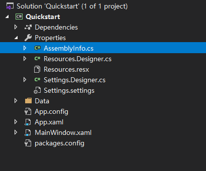

Remove the AssemblyInfo.cs

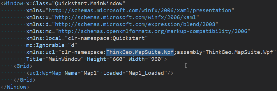

Also change the namespace in XAML.

Change the WpfMap to MapView in XAML.
