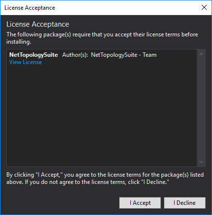

The “NetTopologySuite” is the third part assembly, so the license acceptance is required. You can click “I Accept” to agree the license.

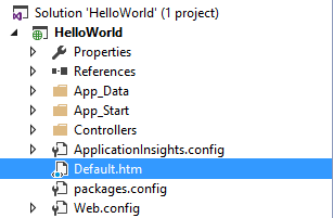

The first step in creating our “Hello World” sample application is to add a html file named Default.htm and include code that similar to the example below.

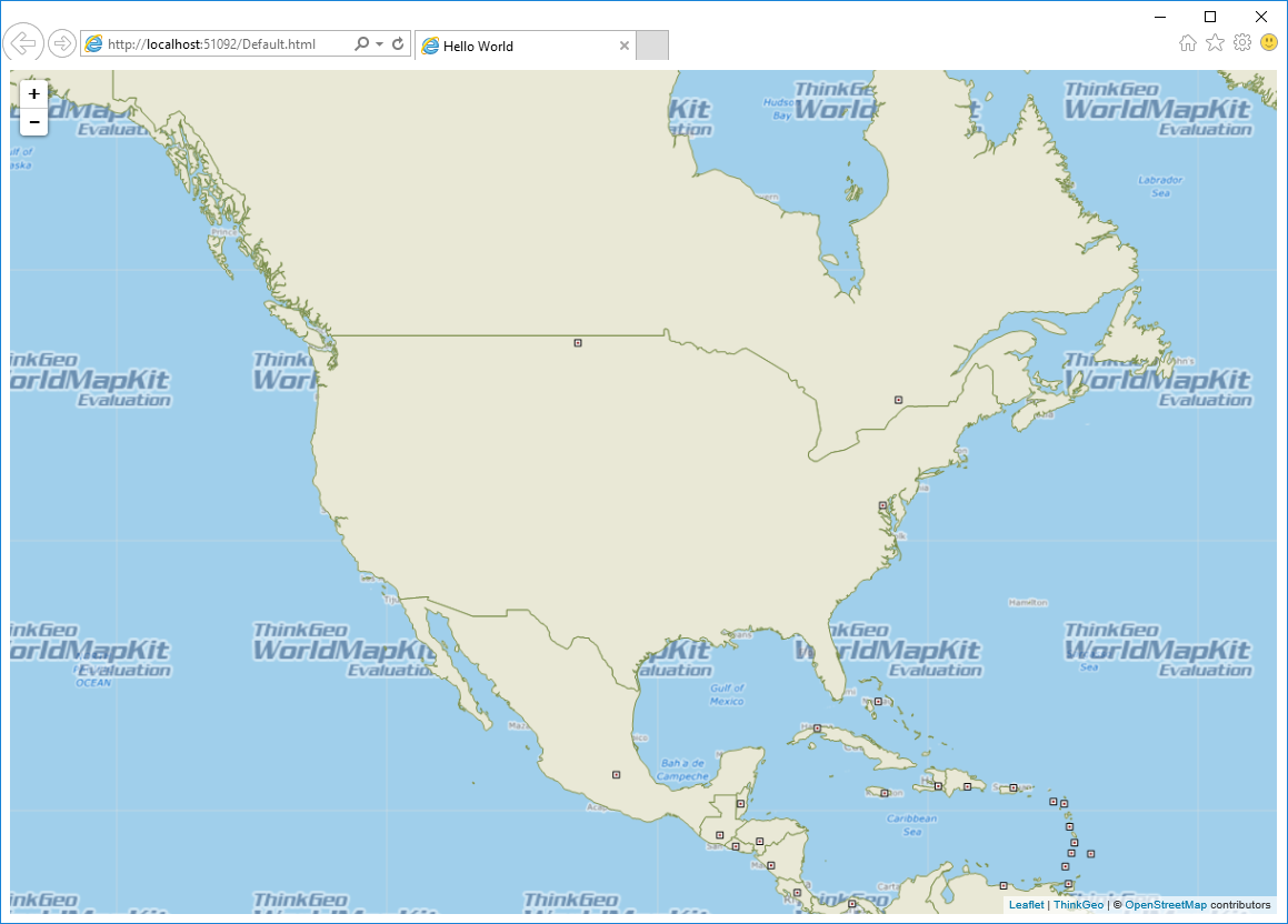

If you compile and run what you have now, your map should look like the screenshot below. (See Figure 7).

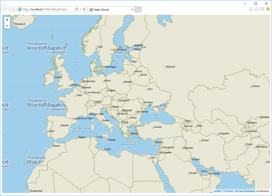

Can you imagine what the map will look like now? Figure 11 below is the result. At first it looks the same as it did in Figure 10. Now zoom in, and watch the map change to resemble Figure 12.
Figure 11. European cities with two ZoomLevels, before zooming in.
Figure 12. European cities with two ZoomLevels, after zooming in.

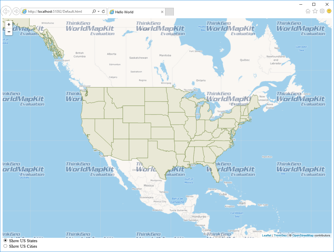

You can click the check boxes for “Show US States” or “Show US Cities” to load different layers to the map. For example, if you check the “Show US States” box, the map should look like this:
Figure 14. Map with states layer shown.
