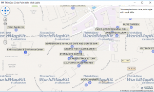

Circle With Mask Label
In our Discussion Forum, we have a user asking for how to label text at world coordinates. For example, how to display a label at a size of 50 kilometers? Now, you can find in this project a custom TextStyle called WorldSizedTextStyle that does that. Whether your map is in Meters, Feet or Decimal Degrees, you can have the labels displayed at the desired size in any real world distance unit such as kilometers, meters, miles, feet etc.
