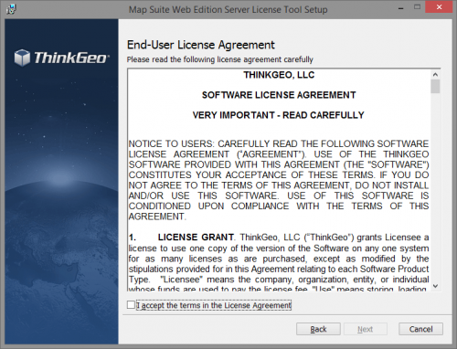

You will then be asked to accept the ThinkGeo software license agreement. Once you have read the license in its entirety, check the box at the bottom of the window and click “Next”.

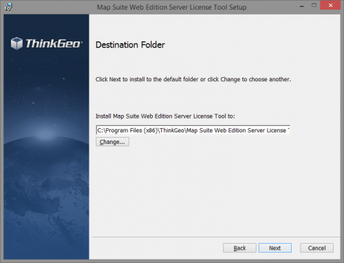

On this step, choose the installation directory for your server license information. The default is typically fine. Then, click “Next”.

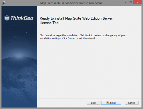

Your production server license is ready to be installed. To proceed, click the “Install” button. At this point, you may be asked to enter credentials for an administrator account on Windows Vista / Server 2008 or higher. Make sure you say “Yes” to the User Account Control prompts, or your production server license will be unable to install.
The installation will proceed, and a blue bar will indicate its progress until it is complete.

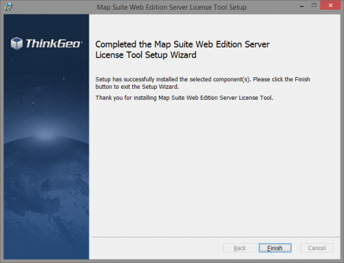

When the installation finishes successfully, you will be shown the following screen:
Click the “Finish” button to exit the installer.
Your production server license is now installed! To test it, launch or access your Map Suite application at runtime and ensure that your maps are displaying correctly and without any watermarks.

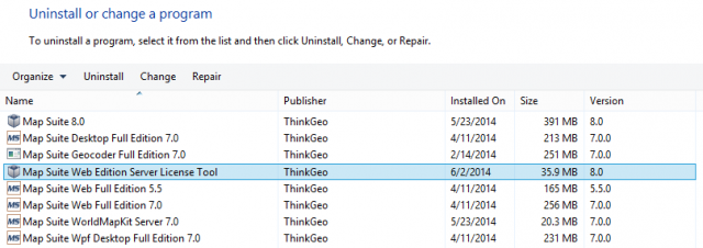

To remove a production server license, simply open the Windows Control Panel, select “Uninstall a program”, and then locate the server license in the list of installed software. Its name will begin with “Map Suite” and it will indicate the product edition that the license is associated with; for example, “Map Suite Web Edition Server License Tool”.
If there is more than one version of the Map Suite server license on the machine, please ensure that you are removing the correct version. Then, simply double-click the item to uninstall it.
If you installed the server license as a “Production Server” type, uninstalling will free up one server license activation in your ThinkGeo account. This means you can reinstall the server license later at any time, or on a different server. Please note that your server will need to have an active Internet connection in order for your license to be freed.
