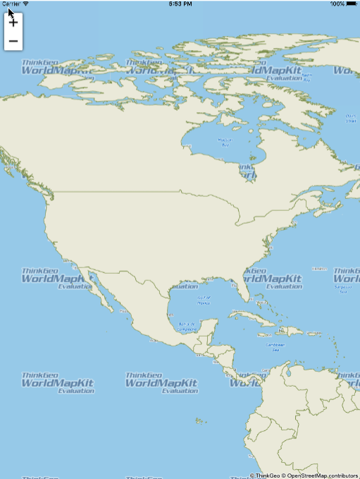

Now let's look at a code sample to bring this concept to fruition. We'll look at ShapeFiles relating to the entire world. In our example, we have one such ShapeFile:
*world wide country borders (cntry02.shp)
(NOTE: The data used here can be found in the attached sample above in the “\AppData” folder. The data files' build action should be “Content”.)
Our next step is to define and add our layers. All of the following code can be placed in the “ViewDidLoad”​ event of the form. Here is the code to use for our example.
public override void ViewDidLoad()
    base.ViewDidLoad();
    MapView mapView = new MapView(View.Frame);
    View.Add(mapView);
    // Set the Map Unit to DecimalDegrees, the ShapeFile’s unit of measure.
    mapView.MapUnit = GeographyUnit.DecimalDegree;
    WorldStreetAndImageryOverlay worldStreetsAndImageryOverlay = new WorldStreetAndImageryOverlay();
    // Add a WorldStreetsAndImageryOverlay.
    mapView.Overlays.Add("WorldStreetsAndImageryOverlay", worldStreetsAndImageryOverlay);
    // Create a new Layer and pass the path to a ShapeFile into its constructor.
    ShapeFileFeatureLayer worldLayer = new ShapeFileFeatureLayer("AppData/cntry02.shp");
    // Set the worldLayer with a preset Style, as AreaStyles.Country1 has YellowGreen background and black border, our worldLayer will have the same render style.
    AreaStyle areaStyle = new AreaStyle();
    areaStyle.FillSolidBrush = new GeoSolidBrush(GeoColor.FromArgb(255, 233, 232, 214));
    areaStyle.OutlinePen = new GeoPen(GeoColor.FromArgb(255, 118, 138, 69), 1);
    areaStyle.OutlinePen.DashStyle = LineDashStyle.Solid;
    worldLayer.ZoomLevelSet.ZoomLevel01.DefaultAreaStyle = areaStyle;
    // This setting will apply from ZoomLevel01 to ZoomLevel20, which means the map will be rendered in the same style, no matter how far we zoom in or out.
    worldLayer.ZoomLevelSet.ZoomLevel01.ApplyUntilZoomLevel = ApplyUntilZoomLevel.Level20;
    LayerOverlay layerOverlay = new LayerOverlay();
    // Add the ShapeFile layer to the layer overlay
    layerOverlay.Layers.Add(worldLayer);
    // Add the layerOverlay to map.
    mapView.Overlays.Add(layerOverlay);
    // Set a proper extent for the map. The extent is the geographical area you want it to display.
    mapView.CurrentExtent = new RectangleShape(-134, 70, -56, 7);
    // We now need to call the Refresh() method of the Map view so that the Map can redraw based on the data that has been provided.
    mapView.Refresh();
If you compile and run what you have now, your map should look like the one below. (see Figure 10).
Figure 10. A Sample map of Europe.
So what has occurred here? We've created a layer and added it to the map and the map has rendered it according to its default style parameters. Also, We have used ZoomLevel to display the map the way that we want.
NOTE: It is important that the “MapUnit” property of a map object be set using the “GeographyUnit” enumeration. This is because the coordinates stored in a ShapeFile can be in DecimalDegrees (a format of latitude and longitude), feet, meters, or another unit system. Our map has no way to know what the ShapeFile's unit of measurement is until we set it. This information is normally found somewhere in the ShapeFile's documentation (also referred to as its metadata), or within its supplemental data file, as discussed in the section on ShapeFiles. It may also come as a separate .txt, .xml, or .html file that begins with the same file name as the main ShapeFile.
With the code above, you can both display a map and navigate it. You can pan by touch on the device and move finger around; zoom in/out by pinch on the screen with two fingers; double tap to zoom in to the next zoom level. Very powerful for just couple lines of code, isn’t it?

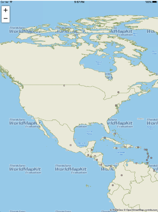

That was an easy start! Now, let's add another Shapefile to the sample so that we will have a total of two layers:
  1. World country borders (“cntry02.shp”)
  2. World capitals (“capital.shp”)
    base.ViewDidLoad();
    View.Add(mapView);
    ShapeFileFeatureLayer capitalLayer = new ShapeFileFeatureLayer("AppData/capital.shp");
    // Similarly, we use the presetPointStyle for cities.
    PointStyle pointStyle = new PointStyle();
    pointStyle.SymbolType = PointSymbolType.Square;
    pointStyle.SymbolSolidBrush = new GeoSolidBrush(GeoColor.StandardColors.White);
    pointStyle.SymbolPen = new GeoPen(GeoColor.StandardColors.Black, 1);
    pointStyle.SymbolSize = 6;
    PointStyle stackStyle = new PointStyle();
    stackStyle.SymbolType = PointSymbolType.Square;
    stackStyle.SymbolSolidBrush = new GeoSolidBrush(GeoColor.StandardColors.Maroon);
    stackStyle.SymbolPen = new GeoPen(GeoColor.StandardColors.Transparent, 0);
    stackStyle.SymbolSize = 2;
    pointStyle.CustomPointStyles.Add(stackStyle);
    capitalLayer.ZoomLevelSet.ZoomLevel01.DefaultPointStyle = pointStyle;
    // This setting also applies from ZoomLevel01 to ZoomLevel20, so city symbols will be rendered in the same style, no matter how far we zoom in or out.
    layerOverlay.Layers.Add(capitalLayer);
    mapView.Refresh();
And the result is as following (Figure 11):
Figure 11. A map of Europe with the additional borders and capitals layers displayed.

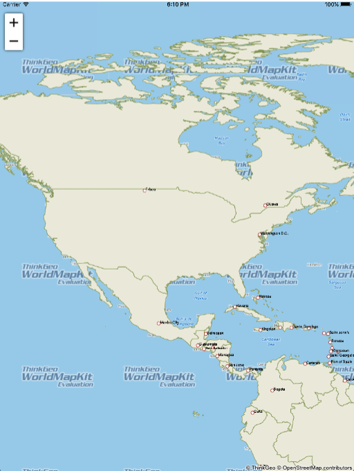

How to Use TextStyle
A TextStyle ​is used to label items on map. As every ShapeFile ​has a relative .dbf file that includes descriptions for every record, the most common way to use TextStyles is for labeling. For example, WorldCapital Shapefile'​s corresponding .dbf file contains the field “​CITY_NAME”​. We can use this field to label the cities on our map.
Map Suite includes several built-in TextStyles to help us quickly apply attractive city labels. We can simply pick the TextStyle we like and use it.
    base.ViewDidLoad();
    View.Add(mapView);

    ShapeFileFeatureLayer capitalLabelLayer = new ShapeFileFeatureLayer("AppData/capital.shp");
    // We use the preset TextStyle. Here we pass in "CITY_NAME", the name of the field containing the values we want to label the map with.
    GeoFont font = new GeoFont("Arial", 9, DrawingFontStyles.Bold);
    GeoSolidBrush txtBrush = new GeoSolidBrush(GeoColor.StandardColors.Maroon);
    TextStyle textStyle = new TextStyle("CITY_NAME", font, txtBrush);
    textStyle.XOffsetInPixel = 0;
    textStyle.YOffsetInPixel = -6;
    capitalLabelLayer.ZoomLevelSet.ZoomLevel01.DefaultTextStyle = textStyle;
    capitalLabelLayer.ZoomLevelSet.ZoomLevel01.ApplyUntilZoomLevel = ApplyUntilZoomLevel.Level20;
    // Since the map is drawn with tiles, the label needs to draw on the margin to make sure the text is complete after joining the tiles together.
    // Create a new Layer Overlay to hold the layer we just created
    layerOverlay.Layers.Add(capitalLabelLayer);
    mapView.Refresh();
The result should look like this (Figure 12):
Figure 12. Map of Europe with TextStyle applied.

Can you imagine what the map will look like now? Below is the result. At first it looks like Figure 7, then like Figure 8 as you zoom in further.
Figure 7. A map of Europe with two ZoomLevels, before zooming in.
Figure 8. The same map with two ZoomLevels, after zooming in.
