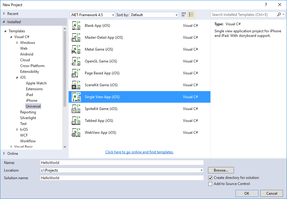

Let's start by creating a new iOS Universal project in Microsoft Visual Studio (2015 or newer) named HelloWorld (see Figure 1). We can create the project with .NET Framework 4.5 or higher.
The project HelloWorld is created in a new solution called HelloWorld. The wizard creates a single iOS Application.

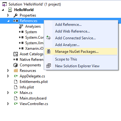

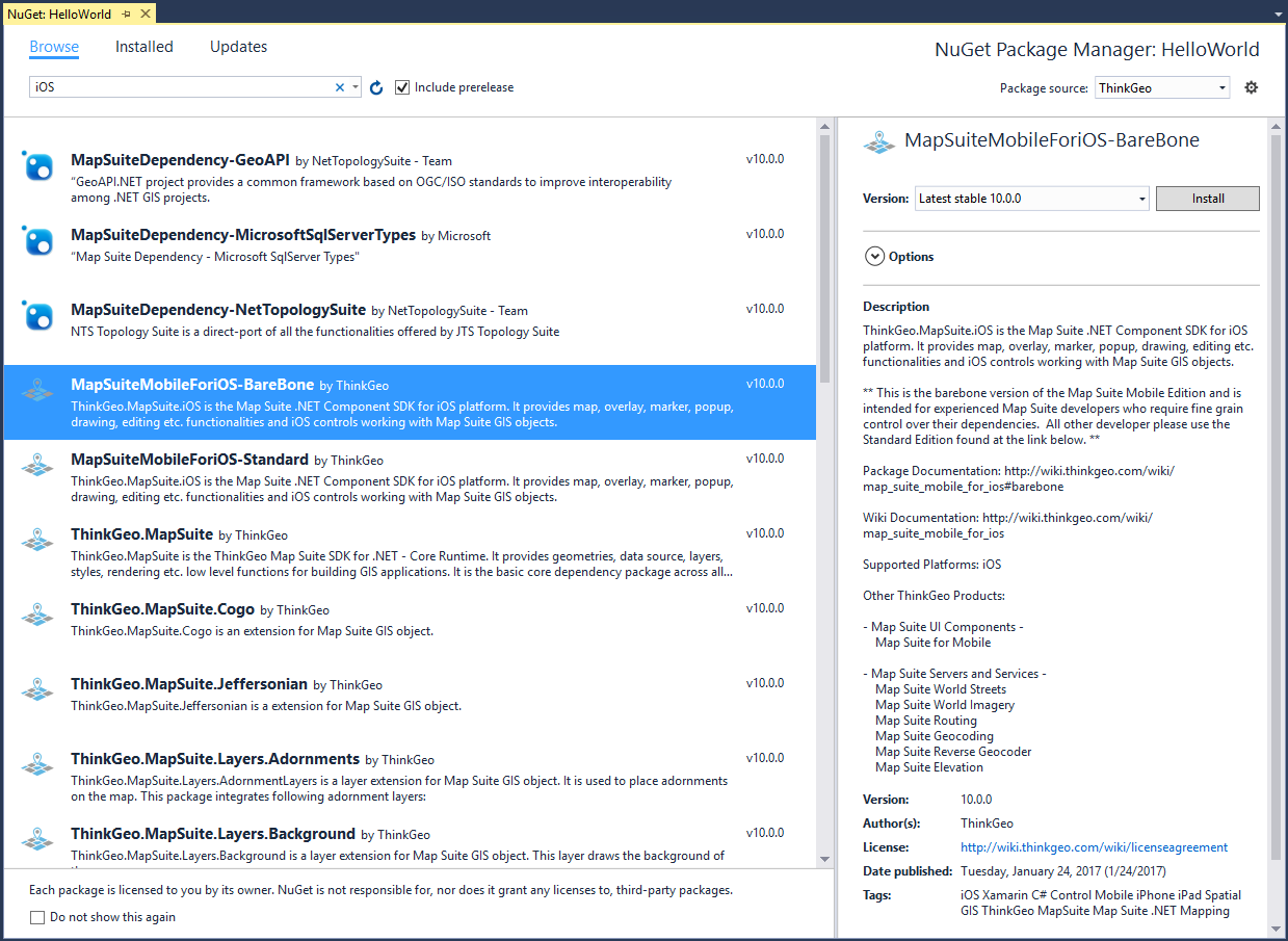

Now let's open NuGet dialog and install the three Nuget packages.
Figure 2. Open NuGet Manager UI in the Visual Studio IDE.
Figure 3. Install iOS package.
Figure 4. Install ShapeFile layer package.
Figure 5. Install style package.

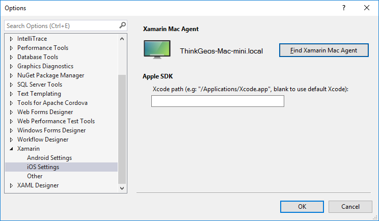

In Windows for Visual Studio 2015 or newer, Go to Tools > Options in Visual Studio and open the Xamarin > iOS Settings panel to access the iOS Mac Build Host settings:
Figure 7. Accessing the iOS Mac Build Host settings.
You can change the Mac Build Host by clicking the Find Mac Build Host button. The following screen is displayed to update the Mac Build Host:
Figure 8. Updating the Mac Build Host.
Note: The version of Xamarin.iOS being used with Visual Studio must be the same as on the Mac. The simplest method to keep them in sync is to have both machines running on the same branch (e.g. both on the Stable release branch).
