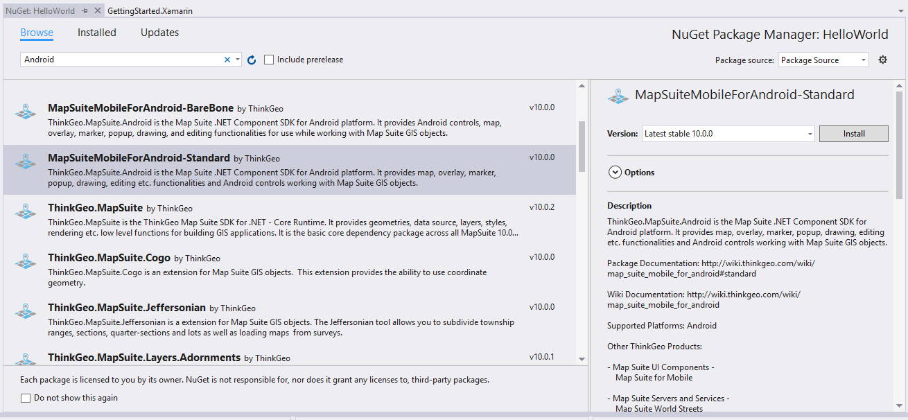

Now we are going to install MapSuite Mobile for iOS NuGet package. Let's open NuGet Manager dialog and install following three NuGet packages.
Figure 2. Open NuGet Manager UI in the Visual Studio IDE.
Figure 3. Install Android Package.
