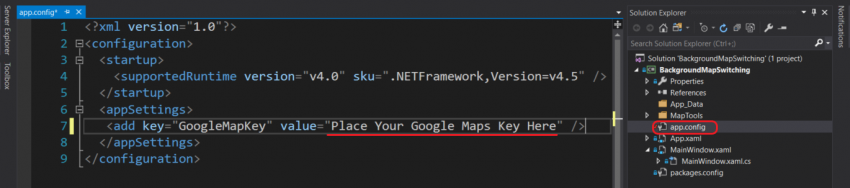

How to Apply Key
<pic1>
  1. Open the app.config file.
  2. Place the key to the appropriate field. (see pic1 above)
