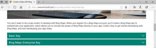

Basically, there are two types of bing maps key. One is Basic Key, and the other one is Bing Maps Enterprise Key. ( see pic1 below )

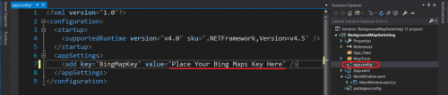

<pic2>
  1. Open the app.config file.
  2. Place the key to the appropriate field. (see pic2 above)
